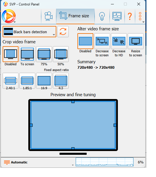

I don't know how to get rid of this, MPC resizing old 4:3 tv shows on 16:9 monitor to 4:3 or like 21:9.
It didn't happen on previous versions.
I tried to change Alter video frame size to Disabled, but it had no effect!
Can you advice? It resizes sometimes back, but it is annoying AF! And only restart of video player helps other times!
I tried use MPC-HC 64 bit ,or PotPlayer, same issue.
Now I am looking at it, i tried to check Fixed Aspect Ratio 16:9, i completely overlooked that i am blind big_smile
I will answer whether or not it helped...
svp settinggs.png, 37.94 kb, 540 x 613
Re: SVP resizing 4:3 tv shows constantly
Open one by one video filter and check frame size at each step.
While playback MPC-HC menu Play > Filters > you will see filters list
Check every picture size in every filter at tab Pin Info. Select [IN] Input and [OUT] Output.
You will get answer there.

What says MediaInfo about your file?
The same size as at SVP screenshot? 720x480
What about Display aspect ratio value?
