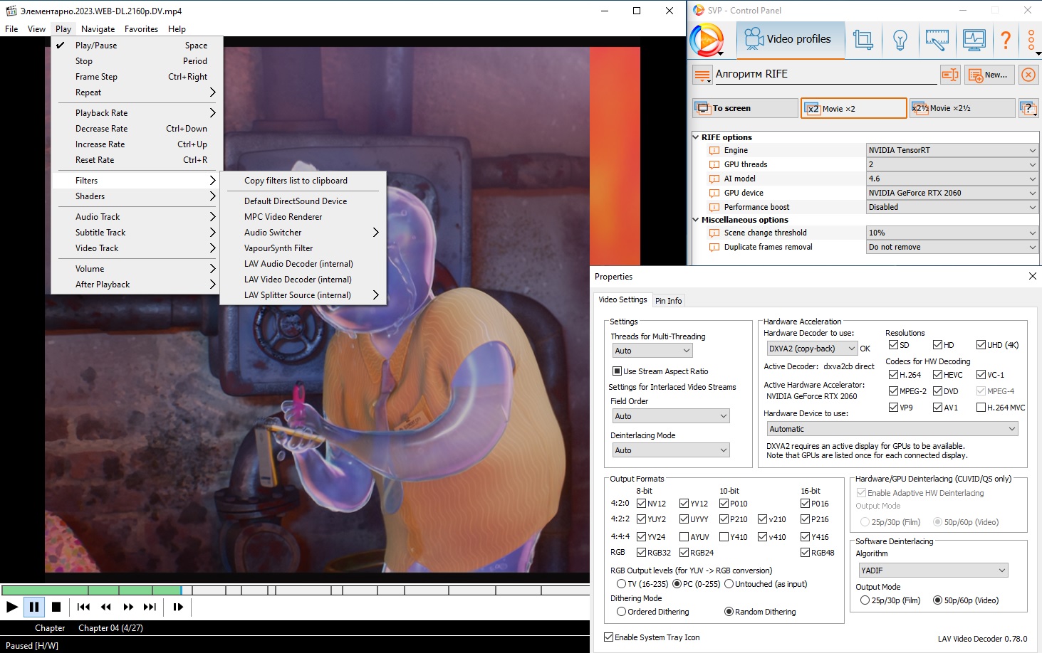

renderer: MPC Video Renderer
filter: Vapoursynth Filter

not sure what you mean
https://www.svp-team.com/forum/misc.php?action=pun_attachment&item=5674

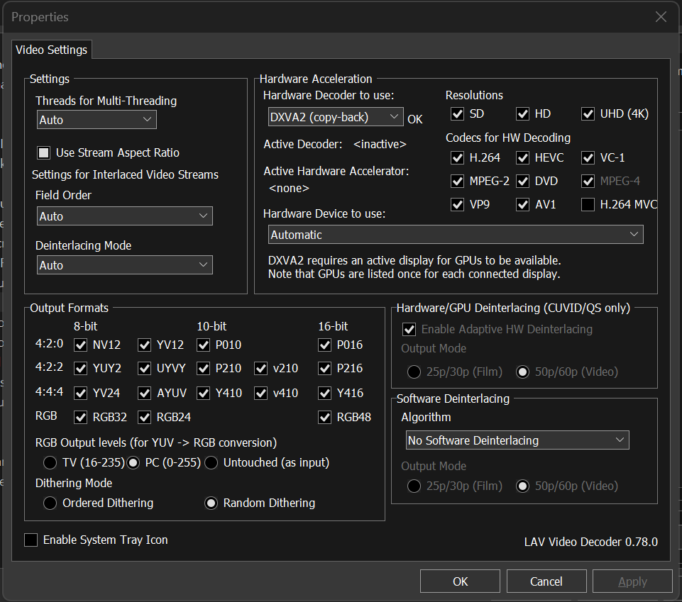

I think I figured out my issue. On mine, the active decoder shows <inactive> and I have to select the LAV Video Decoder in the list you showed every time I start up MPC-HC. I'm guessing there is a setting I need to change somewhere so it defaults to the LAV Video Decoder.

Re: MPC-HC + SVP + Dolby Vision + RIFE
You need to start playback video in MPC-HC player to make LAV Video decoder active.
I did before I screenshotted that pic. It will not auto activate without me going in and selecting it for every video, even if I select it then close MPC-HC.
