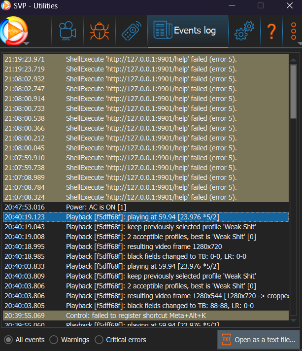

Hello, I turned on Remote control in SVP settings, but I can't find a proper guide to understand how to use it. I tried clicking the Help hyperlink below it, but it does nothing. I also tried to find something on the SVP manual, but no luck. I read somewhere that I can access the web api with http://127.0.0.1:9901/ but when i visit the page, nothing appears. I have attached the logs that suggest there is an error accessing the help page.
Can anyone provide a link to the help page or manual where I can understand how to use this feature properly.

Thank you for the reply. I have already seen this guide and turned on remote control. However, I can't use it. Seems the remote control isn't really getting turned on. As you can see in the screenshot I attached earlier, it says there is an error executing the help page. I was wondering if you could tell me how to fix it. I have tried turning it off and on several times, and restarting SVP.
Re: SVP Http Remote Control Not Working
it just says it can't run your _browser_
open the help url in your browser manually then
