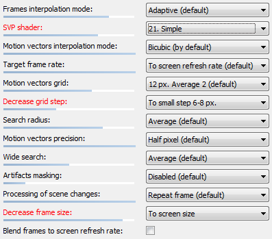

Re: Best Settings for nVIDIA GT555M?
Best options are marked as "default" in each setting wink except that "SVP shader " = "21th" is better than default 13th in my opinion.
"Decrease grid step" is optional - turn it on if your CPU can handle it.
Also in your case it'll be useful to set "decrease frame size" to "to screen size" in 1920 profiles.
http://www.svp-team.com/forum/misc.php?item=1506&download=1
bestsettings.png, 17.56 kb, 397 x 349
