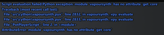

Here is the SVP log, I've tried both Potplayer and MPC-HC. Also, when I try to enable the built-in vapoursynth function in potplayer for testing, it gives me the error shown in the screenshot attached, could that be related?
