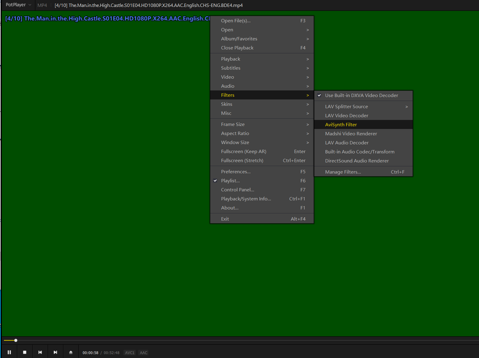

However, when I start SVP with Avisynth Filter enabled, PotPlayer will freeze in 2 seconds after start playing a video (no mater resolution or HDR), and some video it turns into green screen, while I can still hear the audio goes. Then the player just crash if I try to click anything.

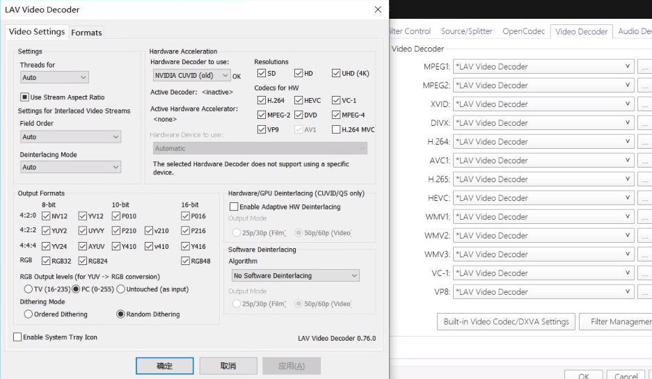

I am giving you a screen shot at the LAV decoder setting page.
LAV.png, 314.1 kb, 937 x 545
