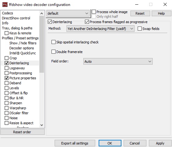

If you mean convert at 48fps with 48Hz you will see more artifacts - its better to have 60Hz or more and use "to screen".
If you have interlaced source be sure to enable "Deinterlacing" on ffdshow (see screenshot)
interlace fix.jpg, 66.29 kb, 551 x 471

Re: My Custom Script Setting Opinion (Smooth like DmitriRender)
I tried these settings and they are good, but *not* as smooth as DmitriRender. And there are more artifacts in some places, like in this scene from Winter Soldier: https://mega.nz/file/RNoFTRSI#ff2Ftwxg6 … 0ZDuFOQsrY
https://i.imgur.com/zKwl6dp.png
Tried all settings variations suggested on this thread but I didn't see any improvement in the artifacts in this scene or smoothness compared to DmitriRender.
Is there any way to really make it smoother?
