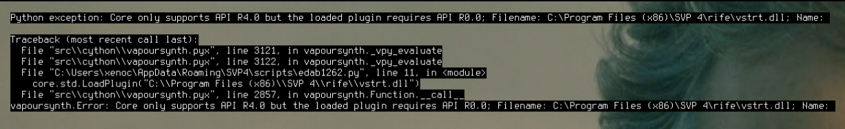

1,638 (edited by Xenocyde 12-06-2024 09:00:03)
Drakko01 wrote:
Do you unselect avisynth , the other thing its under utilities, set environmet variables for VapourSynth
I removed avisynth altogether, only vapoursynth is enabled. But I think I screwed something up now. After reading your instructions I thought it would be a good idea to uninstall and reinstall vapoursynth via SVP. Then I did SVP menu -> Utilities -> Set environment variables for Vapoursynth and now MPC-BE triggers SPV RIFE but I only have generic 4.4 as model and the TRT drop-down is gone. Halp!
L.E.: Looks like it accidentally uninstalled MPV and TRT when uninstalling Vapoursynth. I installed TRT and MPV again but now MPV would not trigger SVP and MPC-BE displays a warning in attached image over the video image. Think I need to install new TRT.
L.L.E.: OK think I fixed it. Overwritten the vsmlrt-cuda folder and vstrt.dll with the 9.2 version and both MPC-BE and MPV trigger RIFE now. Will test MPC-BE for microstuttering.
