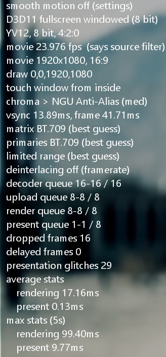

I see two rendering options. Which one should I watch out for?
Screenshot_29.png, 350.27 kb, 328 x 705
both?

I tried making everything at lowest settings, the frames value doesn't go below 41.71ms though. But rendering time in average stats decreased.
Re: Question about a harware conf
41.71 is obviously 1000/23.976, nothing more

> You're not making any sense and not answering my question
the question was "I see two rendering options. Which one should I watch out for?"
the answer was "both" - i.e. both "average stats - rendering" and "max stats - rendering", as there're no more "rendering" words in madvr's stats
> keep telling yourself that.
keep telling myself what? that "41.71 is obviously 1000/23.976", where 23.976 is the source frame rate thus 41.71 is a constant value making your "making everything at lowest settings, the frames value doesn't go below 41.71ms though" a nonsense? ok, I'll keep telling myself that.
