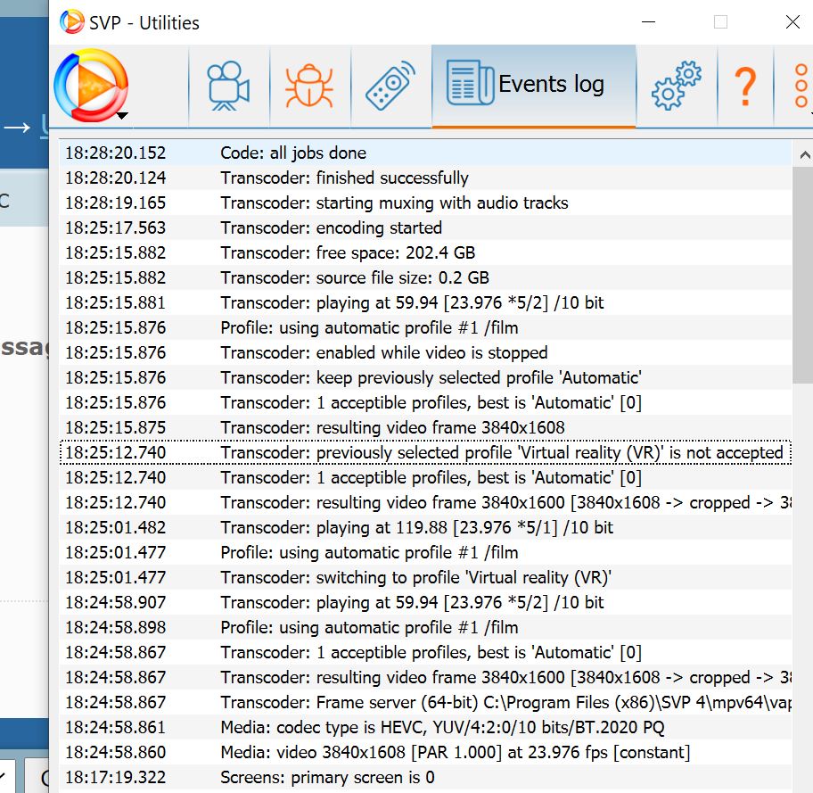

Good call Chainik, i saw strange line in the main SVP log:
18:25:12.740 : Transcoder: previously selected profile 'Virtual reality (VR)' is not accepted

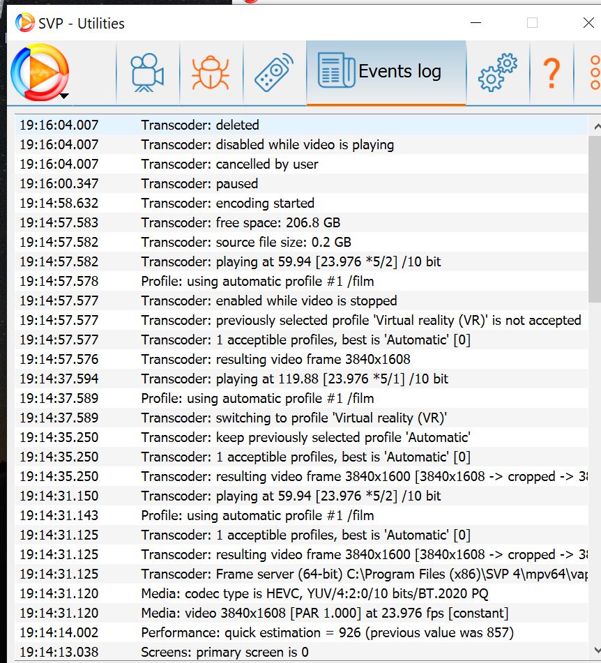

Profile VR is set to 120hz (see the attached screeshot 2 below), seems because this error, it switch back to automatic profile, which is 60hz,BUt the GUI didn't show anything, see the attached screeshot 1 below saying it completes at 120hz successfully.
Full Main SVP log see screenshot 3
Full transcoder log see below, i don't see a problem in there
