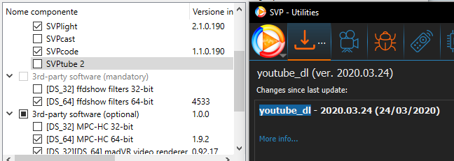

At some point in time I installed "SVPTube 2", then figured I didn't need it and removed it. Problem is, SVP keeps asking to update "youtube_dl" which I think is part of "SVPTube 2". How do I make it stop?
only by manually removing the "ext.tube.ydl" section from the components.xml file (use the plain text editor)

Thank you that worked
