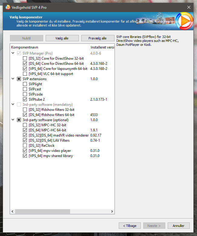

I've been using SVP and MPV together for 4K HDR @48FPS movies for a long time. Last night I decided to format my PC because it kinda needed it.
Today I've installed SVP with all standard optionals + all MPV optionals (please check attached image) and now I cannot play movies 4K HDR @48FPS anymore. It runs smooth for a second or two and then it drops to 8FPS and stays there.
