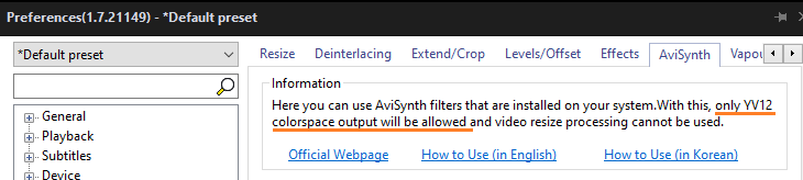

Re: Potplayer - Direct Interface
> Is it possible, that 10bit is now working?
not possible
not only because SVP's plugins for Avisynth supports 8-bit only, but because nothing changed on PotPlayer's side
pot-yv12.png, 10.29 kb, 730 x 164
> not possible, not only because SVP's plugins for Avisynth supports 8-bit only, but because nothing changed on PotPlayer's side
Sad, then PotPlayer, MadVr and SVP's reporting is wrong.
