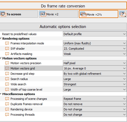

I know that it also depends on what you watch, but what are the best possible settings that would do the best possible job with smoothing and also cancelling out artifacts
These are my settings now. Should I change something?
Also If there are any settings I should change with the script in the SVP folder, then please tell me

Last time I use "cheater" settings.
All as yours, but:
SVP shader: 10. By blocks
Artifacts masking: Disabled
Motion vectors grid: 14 px (in some cases 24 or 28)
Search radius: Small and fast
Wide search: disabled
Width of top coarse level: Small
Processing of scene changes: Blend adjacent frames
These settings give me maximum smoothness.
Some amount of block-artifacts is possible in fast scenes. But it is normal to my eyes. I like such smoothnes smile

Life hack: Switch your screen to 72 Hz or 75 Hz mode to get smooth ratio x3.
It wil give you best results with any settings.
