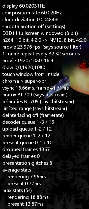

As the title states, I've been getting massive frame drops ever since my windows decided to update to 1803. Everything used to work normally before it but now i can't use SVP since I would get 0-1 present queue in madVR.
What I've tested so far was to use madVR without SVP ( it is working with 0 frames dropped, even when using NGU High Quality , even though i normally use super-xbr 25).

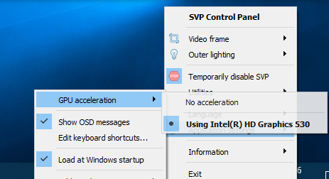

Reinstall Nvidia driver ( latest driver would make SVP to not find the dedicated GPU in SVP, but an older version, such as 391 would make it discoverable again ).

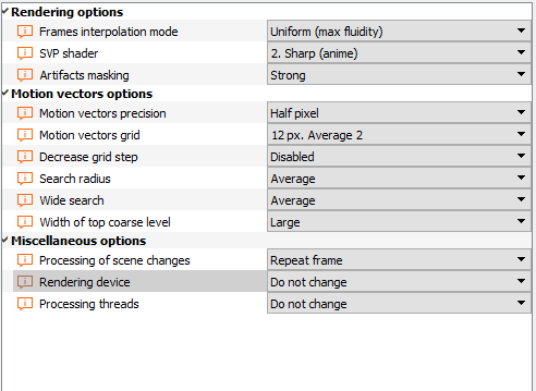

Tried to use SVP with no GPU acceleration, and to reset its settings but still got frame drops, even though sometimes it would take up to a minute for them to drop to 1.
Reinstall SVP and all of its components.

Tried using Bicubic 50 AR but still getting frame drops but I've noticed something in task manager, before the windows update my DGPU usage with SVP would go up to 70-80% but now it barely goes to 40% and IGPU goes to 60% and 100% CPU.
Seems like something is limiting the DGPU usage.

Tried to disable the IGPU, but because my display is connected to the laptop with the IGPU, I can't even open MPC without it.
