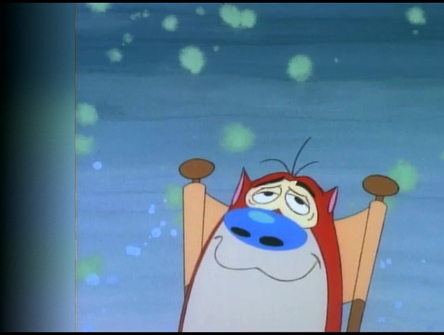

Sorry if this has been covered already.  I searched around but I wasn't quite sure what exactly to call the problem I'm having.  I'm going to try to attach a picture, but I'll explain what the issue is in case it's not clear from the picture.
When I use SVP with LAV video decoders and I go into full screen while watching a 4:3 video, the outer lighting does not show up on the right side at all.  On the left side, the black bar is also unaffected, but the effect usually created by the outer lighting feature shows up just to the right of the  black bar on the left, overlapping onto what should be part of the actual video.  Has anyone ever encountered this problem before?  I''m using the most recent SVP free, MadVR, and LAV with Potplayer.
I just added the picture, and because it doesn't include the black bars on the sides it may be difficult to see what's going on.  It's as if the video is getting pushed off to the right a few inches, so the outer lighting on the left shows up where the left side of the video should be, while the right side of the video gets pushed out completely so it can't be seen at all.  Like everything has shifted to the right a couple inches.  Hopefully I have explained my issue clearly enough.

In that case maybe Disabling Video processing will help. (RC>Video>Video processing filters>Do not use)
Re: Issue with outer lighting when using LAV
Yes!  Thanks so much James D!  That worked.  That's a huge help.  I'm assuming RC was meant to be FC as in Filter Control because that's where I found the option (just to be clear in case someone else with a similar problem stumbles upon this thread).  Anyway, switching the condition to disable under "built in video processing filter settings" is what did the trick.
