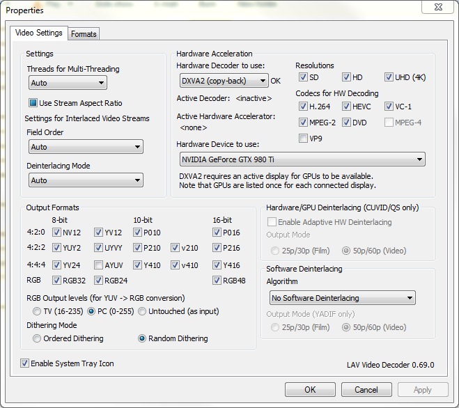

I have GPU acceleration enabled in SVP control panel and "LAV Video filters.exe", but there's still low usage of my gpu. OTOH, my cpu shows high usage (~60+%) on average.
I would love for SVP to use my GPU (GTX 980Ti btw) more, a lot more.
I also wanted to know which LAV video settings so choose. I installed K-Lite Codec pack which automatically installed LAV Video. Then,
after watching a SVP setup video on Youtube, I followed the steps in said video, which involved setting the
"Hardware Decoder to use:"   to DXVA (copy-back) (see the rest of the settings in the image below.) Furthermore,
would someone please tell me which "Software Deinterlacing" to use if it is at all beneficial to the *smooth video experience*.

LAV Video settings.PNG, 65 kb, 659 x 586

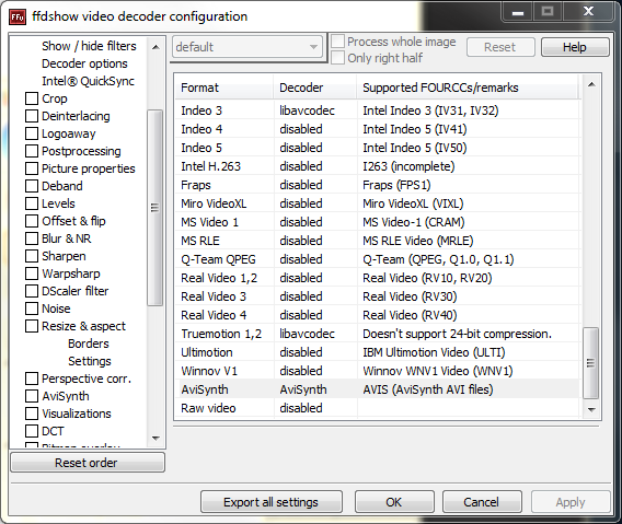

I'm back after trying what you said.
First off, while i'm playing the movie (with PotPlayer), there's this little "ffdshow video decoder" icon that comes up in the system tray.
So i doubled clicked on that, and up came this window. Is this it?
ffd Maybe MadVR.PNG, 53.82 kb, 568 x 479

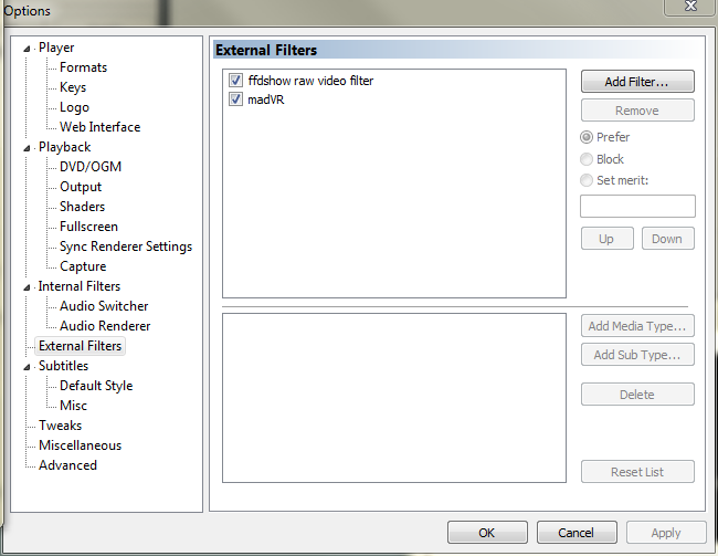

14 (edited by JudeTheDude 12-06-2017 08:46:01)
Re: How can i force SVP to use my GPU more?
- choose madVR as a video renderer in MPC-HC's options
- find the icon in system tray OR via right-click in MPC-HC window -> Filters menu
Hi Chainik,
Okay so i added madVR filter (see the snip below). Now which settings do I tweak?
Thank you again.
Added madVR as External.PNG, 39.44 kb, 650 x 503
not "external filters" section but
playback -> output -> video renderer

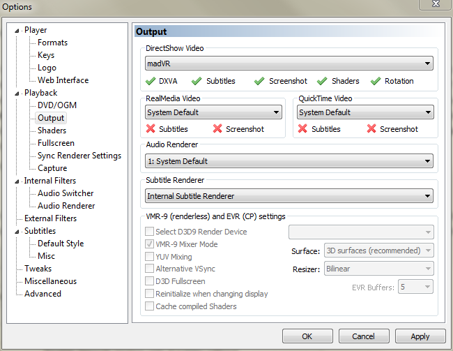

Hey Chainik,
Thank you for that.
So i went to the place and did this (see below). Is that all?
Will madVR use as much gpu horsepower as is available to it?
Do I have to go tweak something elsewhere?
I feel like we're almost there?
Is this it.PNG, 46.44 kb, 650 x 503
