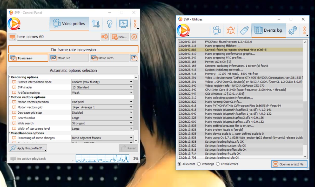

SVP pro stopped working for past 2 days with plex. attaching log and a image, can someone help me. i see in the log  that it is detecting the plex player and video but svp says no active playback in control panel.(video is not interpolated)
tried reinstalling driver still no luck.
Thank you

Re: svp stopped working with plex, need help
Probaly Plex has updated itself.
> VideoPlayer: mpv git-32ff23c
while SVP's build is
> VideoPlayer: mpv 0.24.0-git-0f1afc6
