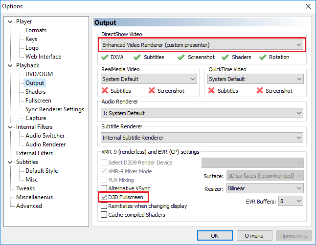

At your screenshot i see one interesting line:
vsync 20ms, frame 41,71 ms
Looks like your GPU is not fast enough to render frame between vsync events.
Try to reduce madVR settings or to select another renderer in MPC-HC.
For example use EVR (custom presenter): MPC-HC menu View - Options... - Output tab
Re: Screen and HDMI output out of sync?
Wow! You're right on the money. I've had to adjust a few more things, but it was definitely a Vsync related issue, and my card was not powerful enough. Now I do not get the issue with nearly everything, except for films that completely fill the screen, ie no black bars.
