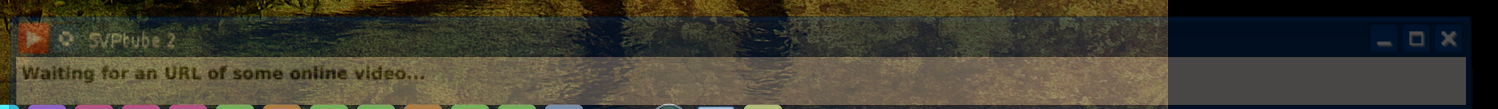

When I click on the option at the top of the SVTube menu, "Show video formats window", a small window pops up saying "Waiting for URL of online video",  which instantly disappears when I left or right click anywhere on the screen.
I have attached a screenshot of that window as it is closing for no reason.
Can you help me figure out the problem?

> The small window still crashes the instant I click
it doesn't "crashes" but hides itself when goes out of focus
