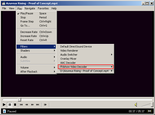

When SVP did not make smooth playback check your filters list.
http://www.svp-team.com/forum/misc.php?item=718
It should contain ffdShow filter to SVP successful work.
I wonder if it depends on current renderer?
Can you show screenshot?
Filters_ffdShow.png, 14.01 kb, 648 x 482

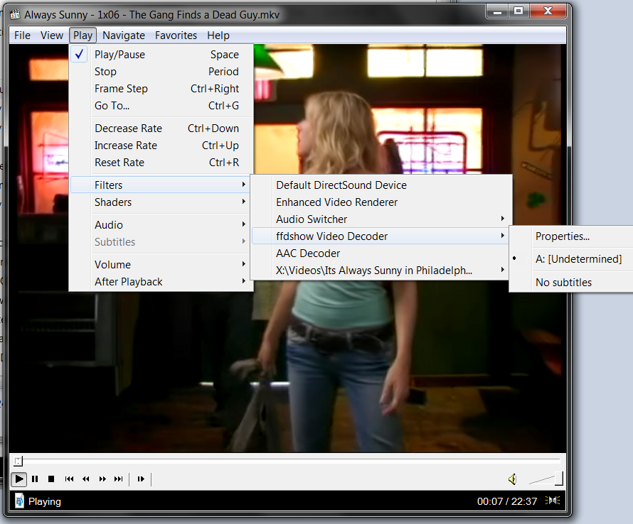

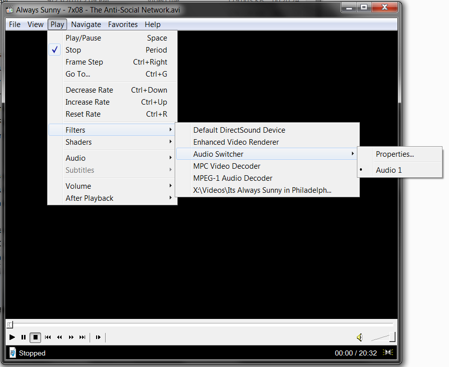

You are correct, ffdshow does show up on that menu when I have SVP, and it is absent when SVP does not kick in...
How can I get ffdshow to be used for all filetypes?
Thanks!
ffdshow.png, 450.43 kb, 890 x 738
noffdshow.png, 66.61 kb, 897 x 733
