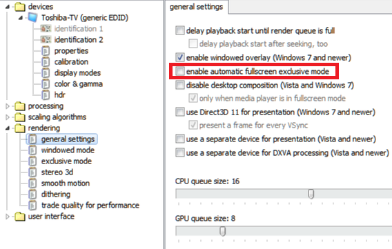

That's because it's using the external madVR presenter for fullscreen.  You can still use the normal MPC-HC controls while still using madVR, but you need to go into madVR's options and set it to use overlay instead.
EDIT: Here's the madVR general rendering settings I personally use for performance reasons, but the only thing you really need to do is uncheck "enable automatic fullscreen exclusive mode":

Re: MCP's UI changes
Ahh, thank you. I looked through those, but never thought it would have been that option.
You the best!
