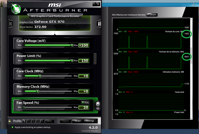

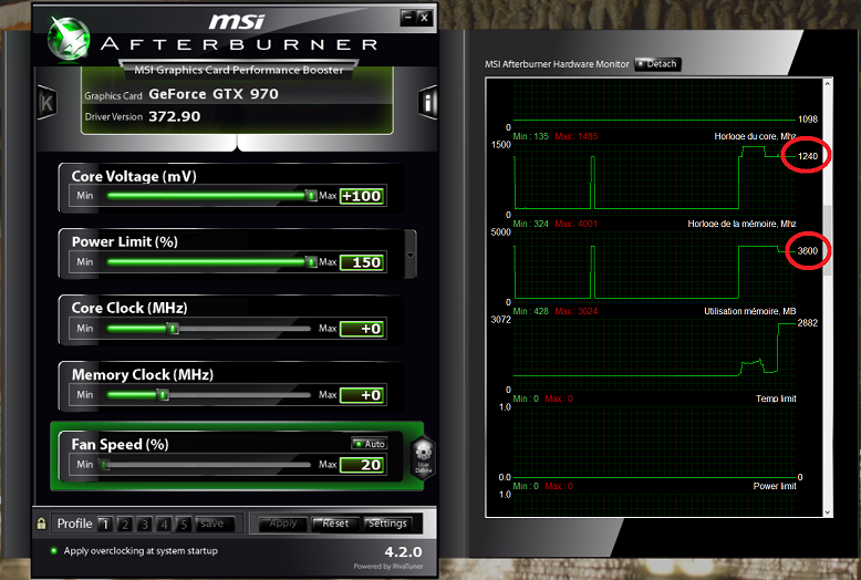

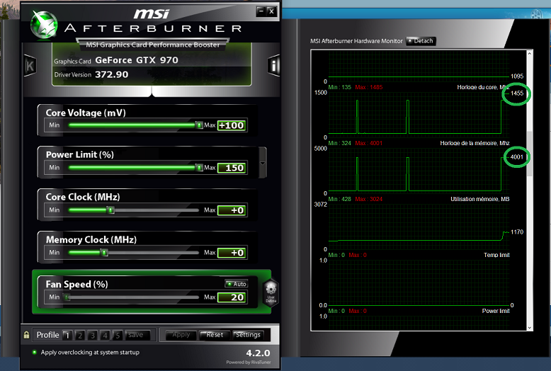

I checked my GPU state and everytime I play a video, it throttles to state 2 (limited GPU/memory frequency) as shown on attachment : in green the normal frequency while playing games, in red the frequencies when using MPC HC
Everything else works fine
Anyone know what is happening ?
frequency throttled MPC.png, 259.94 kb, 778 x 524
frequency under normal load.png, 224.66 kb, 778 x 524
