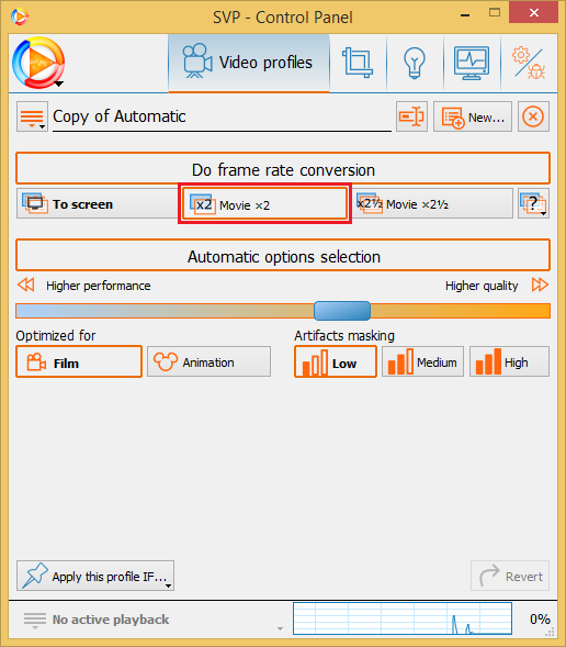

Re: 144Hz Monitor Issue
jeakzy
The option is present.
Create new profile from Automatic and select x2 smooth factor.
SVP4_x2_smooth_factor.png, 31.8 kb, 516 x 589
I don't have two thirds of those options, are you using pro?
jeakzy
Yes. It is screenshot of SVP 4 PRO.
SVP 4 Free don't have option 'Custom target frame rates'. See SVP 4 editions comparison.
But you can switch your 144 Hz monitor to 60 Hz mode. It must work.
