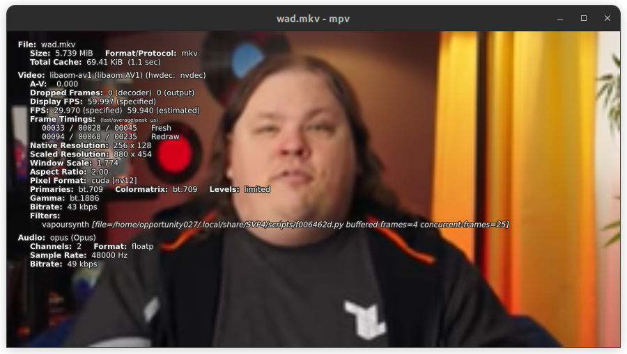

353 (edited by opportunity027 26-07-2022 12:52:53)
Re: SVP 4 Linux
echo --enable-libaom >> ffmpeg_options
When I used "libaom", it was able to decode normally.
Screenshot.png, 414.99 kb, 900 x 509
Re: SVP 4 Linux
You're probably a more experienced Linux user than me, so could you elaborate more specifically on what you did?  I ran that in the terminal and it seemed to do nothing (I honestly didn't think it would) so clearly there's something more specific that one is supposed to do with that.
