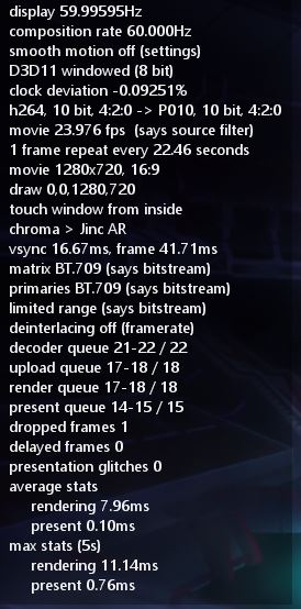

hoover1979 wrote:
The resize options in the renderers (EVR (custom presenter), VMR9, MadVR) do not work on my machine and process all videos lower than 1080p pre-resize and then upscaled in shitty Nearest Neighbor.  So I either get Blocky videos or Flickering ones.
Could you give us the screenshot of MadVR statistics whether the upscale working or not. Press Ctrl+J when playing with MPC-HC.
madvr_stats.JPG, 51.55 kb, 274 x 554
