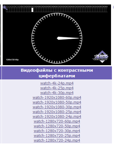

Re: LG 60hz TV with TruMotion similar to SVP?
WolfyAmbassador
Try video 'watch-1920x1280-24p' from this article: http://www.ixbt.com/multimedia/video-me … -1.shtml#4
You need to use the same video mode (24p) when output this video to TV. And you need photocamera with long delay to record several frames in one shot.
from this article
let them all learn Russian at last big_smile
WolfyAmbassador
this's what you want:
http://www.svp-team.com/forum/misc.php?item=3260&download=0
watch.png, 47.56 kb, 382 x 494

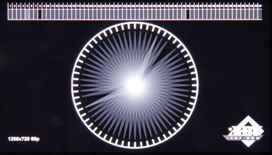

I took 3 pictures with my phone camera, not exactly sure if my camera is 1 second on the shutter, but I know that if I put it in manual focus (which I did), the shutter speed is so fast like a split second. Don't really have another camera to use at the moment, but here's what I got:
https://drive.google.com/file/d/0B-aI5_ … sp=sharing
9 (edited by WolfyAmbassador 09-10-2014 01:06:36)
Is this better? I downloaded an app on my phone that allows me to adjust speed and everything. I put it on speed priority mode, and put it on 1.0" or 1", which I assume is 1 second, and then I took a few pics to test it out, and I decided to use this one for sharing.
UPDATE....Here's another 2 I took with exposure value set to -3.0 because it gets too bright.

I put the ISO sensitivity to the lowest value and I set my phone down:
and now you can start to try to find out how your TV works wink
I came up with 72hz or fps, because of the way I counted the shades in the bar above the wheel, but I had the idea that it might have been 72hz anyway, because the refresh rate has to be equal with 24fps somehow when watching movies. Although 48hz could work, the framerate looks higher than that with trumotion on I also thought maybe 96hz prior to all this testing. I am still unsure.
Also, I've decided to do more tests and have the shutter time set to 2 seconds so it gives the camera long enough time to capture everything I needed to capture.
The test results look slightly different in each capture but not too far off from each other.
So the bright shades are the ones that show interpolated frames?
