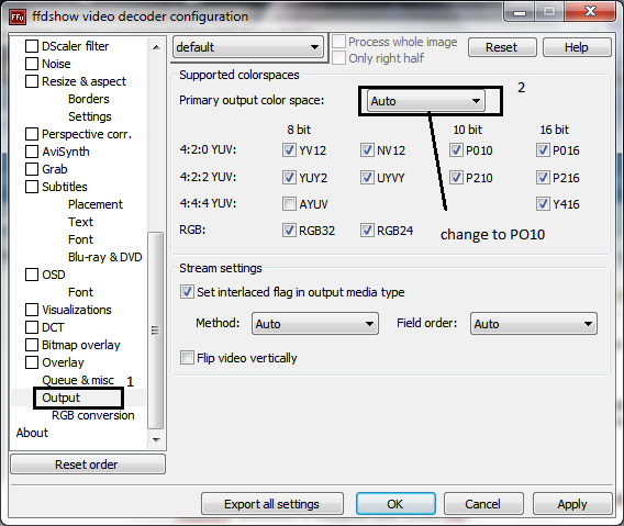

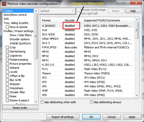

You could make the output to 10-bit by changing the decoder from LAV to libavcodec (ffdshow). Although from my finding it will make huge memory penalty.
You could manually change the ffdshow setting.
http://www.svp-team.com/forum/misc.php?item=3254&amp;download=0
e.g. I played using LAV decoder takes memory about 600-750 mb, when I changed it too ffdshow decoder, it became 800-1000 mb.
While 8/10-bit precision is about encoding efficiency, the 8/10-bit output about the color matrix. Since I couldn't sure how to differentiate the color precision, I opted use LAV decoder (it's lighter than libavcodec too  big_smile )
You could forcefully to display in 10-bit by changing the output setting too smile
http://www.svp-team.com/forum/misc.php?item=3256&amp;download=0
Although the 8-bit video will be displayed in 10-bit too big_smile. But honestly I couldn't really spot the difference
ffdshow setting 1.png, 81.76 kb, 568 x 479
ffdshow setting 2.png, 67.68 kb, 568 x 479

This is when I use libavcodec when playing it
http://www.svp-team.com/forum/misc.php?item=3258
1. It works fine with output in 10-bit
2. Need to disable LAV decoder in order libavcodec to work.
3. Enable libavcodec in ffdshow setting.
4. The svp manager works fine too.

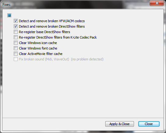

Back to topic, I think the inability to display the video is laid in renderer.
There's a high chance that some of broken filter in registry. And it's take higher priority than renderer from SVP.
If you're using K-Lite, there's a tweak tool that fixes that. It can detect and remove the broken filter, and re-register the DirectShow
http://www.svp-team.com/forum/misc.php?item=3259
fixes.png, 45.72 kb, 544 x 438

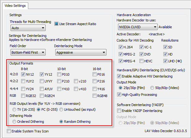

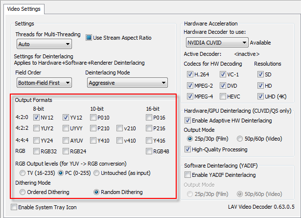

To maximum save color gradients in Hi10p video with SVP after few experiments I came to these LAV Filters settings:
http://www.svp-team.com/forum/misc.php?item=3313
LAV Filters did dithering very fine and SVP works with maximum quality. These settings gives me no banding with Hi10p video and SVP.
LAV_Hi10p_settings.png, 42.97 kb, 615 x 445

It's sad to see that someone tried but still didn't get all pros of 60f playback feature.
When I install SVP bundle I never include madVR render installation. In fact I also don't use MPC in the first place and use Daum Potplyer which obviously you don't want to do.
I also assume that you use 32 bit MPC player from SVP bundle, followed setting up instruction for MPC here http://www.svp-team.com/wiki/SVP:MPC-HC and especially checked that ffdshow raw video filter is set to Prefer.
http://www.svp-team.com/w/images/4/46/Mpchc-external.png
You can try to post pictures of your settings in MPC to see if someone finds smth wrong there.

James D I never included any of that madVR or anything else either, that would defy I bit of the point of letting things be at default settings, so I've just let it install as is from the bundle with everything the way it is at default. Also yes, everything default included the MPC from the bundle that's 32bit.
I checked those settings and the only differ I found was that hardware decoder to use was the same for me as in the picture above posted by Mag79 i.e. NVIDA CUVID. I tried changing that to DXVA2 (copy-back) as the settings you linked to instructed. But it hasn't changed anything.
As it is, the bundle just isn't working so well by default in that it doesn't show the image of the video by default, and no amount of the advice or tweaking from here has been able change that to this point. Yeah it is sorta sad. But for now I've just uninstalled the whole bundle and installed MPC by itself so I can at least watch stuff, perhaps when this project reaches a later maturity in some future I can check it out again. For now, I'll just use my time for some other things instead.  cool
