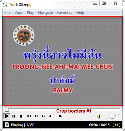

You can get 4 different crop borders on this video.
http://www.svp-team.com/forum/misc.php?item=3161
Auto Crop option uses several seconds of video to detect borders. After moment when crop is applied borders detection stops to work.
To get right border detected use Auto Crop disable/enable hotkey Ctrl-Shift-C and enable it at position in your file what you need.
Logo at black borders is cropped in any case (see borders #4).
AutoCrop_borders_ani.gif, 195.07 kb, 400 x 418
