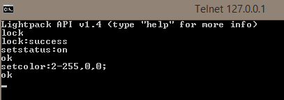

so try to set LEDs color with direct API from cmd window
I suppose it 'll work for LEDs number 1-10 and won't work for others
I'll contact Lightpack developers in that case wink

just forgot to say if lights are off you need to turn them on first with the command
setstatus:on

Yep, turning them on via telnet works up until number 10, any higher than that and it just returns "error."
