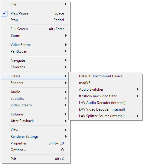

I use MPC-HC 1.7.1 and internal splitters and decoders. To do that you need to download MPC-HC x86 latest version and check all options at page Vew - Options - Internal filters.
After that when open video file in player filters list must be like this:
http://www.svp-team.com/forum/misc.php?item=2961

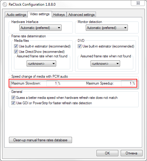

I did modifications to SVP-Manager SVPMgr315.1015_ReClock_mod:
- added detection of ReClock loading with player;
- ReClock Slowdown/Speedup settings used to calculate more accurate smooth factor;
- added info about it in additional info file.
Instructions: download, exit SVP-Manager and replace files in the SVP folder.
