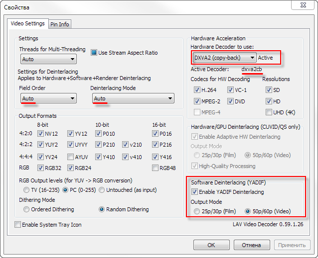

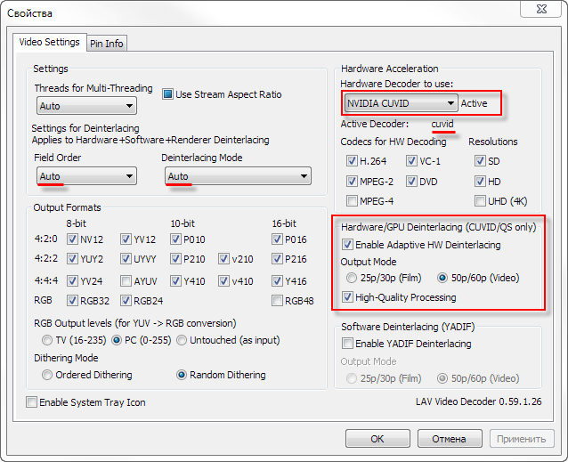

The best solution is to use hardware deinterlace in the decoder. It can be implemented in LAV Decoder if you use HW Decoder NVIDIA CUVID or Intel QuickSync.
http://www.svp-team.com/forum/misc.php?item=2952
But you have AMD CPU and AMD GPU. In your case you can use HW decoder DXVA2 (copy-back) and software deinterlace in LAV Decoder.
http://www.svp-team.com/forum/misc.php?item=2953
Deinterlace in SVP menu (it is just control of deinterlace option in ffdShow) is old and inconvenient tool at this moment.
LAV_CUVID_HWdeint.png, 23.76 kb, 638 x 519
LAV_DXVA2cb_SWdeint.png, 24.26 kb, 638 x 519
