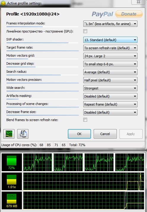

Thanks, can you also share a screenshot of your actual SVP settings on your Active Profile window?
Re: High CPU Usage with SVP?
http://www.svp-team.com/forum/misc.php?item=2937
its not clear 5G, I am testing settings now

Just got what 5G means smile Thanks for the settings, can you explain why you changed "Frame Interpolation Mode" and "Motion Vectors Grid"?
Rimsky does use these changes because it reduces artefacts.
1,5m does trades less artefacts for less (quiet a lot less) smoothness.
24 pixel grid does the same. (less artefacts, but less smoothness (almost not noticable less))
Specially thin objects like swords, staffs, guns but also prison bars, shutter blinds etc catch a lot artefacts if one uses a small grid. Larger grids reduce these problems.
24px grid does also decrease CPU load.
Zachn
1.5v and 24px grid make video artifactless
decrease grid step to 6-8px make smoothness more precision
yep, but decrease grid step load CPU more than 24px decrease CPU load
