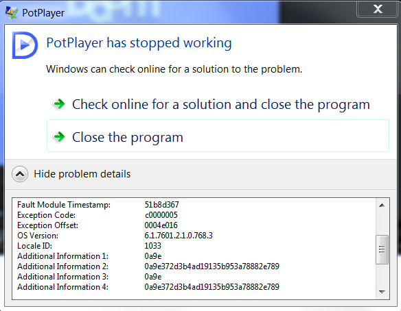

Topic: PotPlayer has stopped working
All of this is a bit overwhelming so I have no idea where to start with this error. I am trying to play Blu-ray ISO's created with AnyDVD HD and when I add the correct playlist file PotPlayer crashes to what you see in the screen shots. Maybe PotPlayer can't handle ISO files ???
I carefully went through all the installation  instructions and I still get this error.
If I go into Preferences in PotPlayer > Filter Control > Global Filter Priority and Preset Filter Priority and uncheck "ffsideshow raw video filter", it plays fine, but then there is no SVP.
Windows 7 64 bit
AMD 8 core at 3.1 GHz
NVIDIA GT610
8 GB of RAM.
If the video card isn't powerful enough I can get a better one.
Thanks for any help !

Re: PotPlayer has stopped working
PotPlayer's binary (PotPlayerMini.exe) isn't patched for high memory consumption by default. Use "4GB patch" on it.
http://www.svp-team.com/wiki/FAQ#Video_ … time_error
("4gb patch" is included in SVP's full distro)

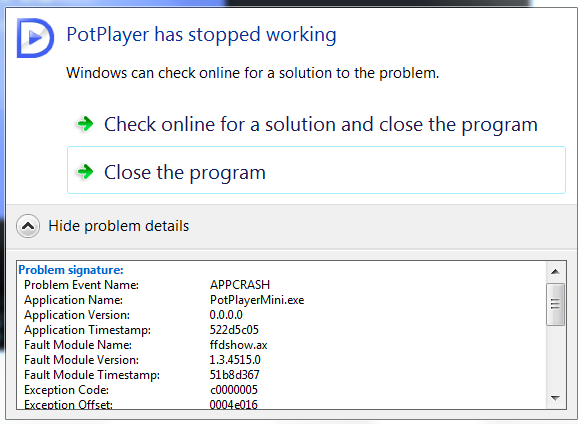

I tried installing things on a different machine thinking that it may make a difference, but I still get the same crash on the other machine as seen in the screen shots. This time I installed the full version of SVP. This computer has 4 GB of RAM so the patch is needed and as you posted the patch is included in the full installer.
Should I have checked the madVR box off in the full installer ? (I didn't do that because it said in the forum it isn't required).
Thanks.
hmm let's start it over
You don't need to reinstall all software over and over or try to do the same on another machine. Also the fault isn't depends on available RAM size at all.
All you need is to run "4gb patch" manually and point it to "PotPlayerMini.exe". That's all.

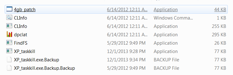

I'm sorry I just don't understand what you mean to run the patch manually. I extract the file with WinRAR and click on the patch and I allow it to open. I get what you see in the screen shot. Clicking on any one of the files shows what I get in the second screen shot.
you need to find PotPlayer's installation folder in the first "Select Executable..." dialog and select "PotPlayerMini.exe"

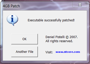

I found the  "PotPlayerMini" file.
It is right file. There is only one potplayermini file in the folder. "exe" part may be invisible in your system. Apply patch to this file:
Start menu - programs - SVP 3.1.5 - Utilities - 4GB Patch - choose potplayermini - Open - "Patched successfully" - OK.
http://www.svp-team.com/forum/misc.php?item=2919

Thanks for that, that's what was needed. However it did not solve the crash problem. In the playlist I chose a small file of only 1 minute and 42 seconds (the movies start screen menu loop) and that worked, however the function of PotPlayer was sluggish although the CPU usage was at around 30 to 40%. I'm thinking that my platform isn't up to the task and that's why it's crashing.
I have also tried the latest version of ffdshow, (4525_2131117) and that didn't help either. It's acting as if SVP and Potplayer are not making use if the processor. It helps to let the video card do 100% of the work ( a little).
One more thing, I couldn't find the potplayermini file where you said it would be, here is  a screen shot of what's there.
I found the file in the Potplayer in Program Files(x86) > Daum > Porplayer. I am not sure if this is where I was supposed to go, but it's the only place where the Potplayermini file is.
The other thing it could be is the patch didn't take and SVP is only running on 2 or 3 gigs of RAM. If that's the case I am about at my wits end here...
