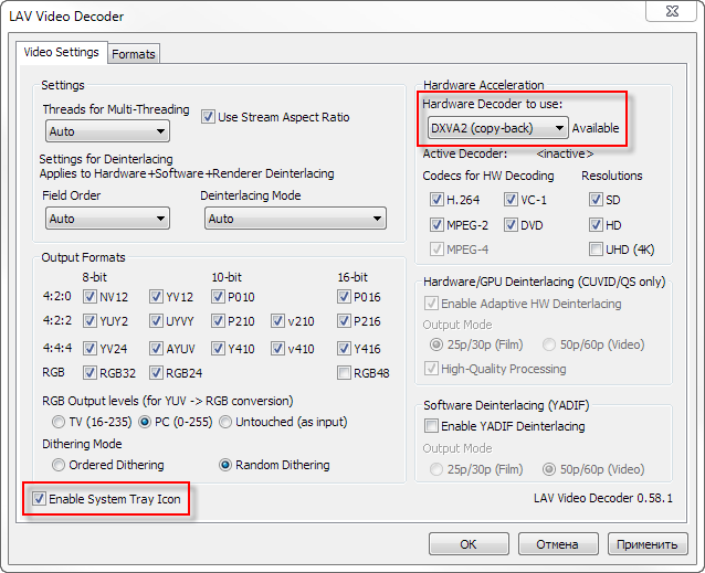

Lets start from beginning. Open LAV Video Decoder properties and check these options.
http://www.svp-team.com/forum/misc.php?item=2889
After that when you play the video in stereoscopic player is the LAV icon appears in the system tray?
LAV_settings.png, 57.98 kb, 638 x 519

made changes to LAV Video Decoder....it shows icon when using Media Player Classic....doesn't show up with stereoscopic player

LAV must be decoder. Its icon must appear in the tray.
ffdShow must be post processor. Its icon must appear in the tray.
