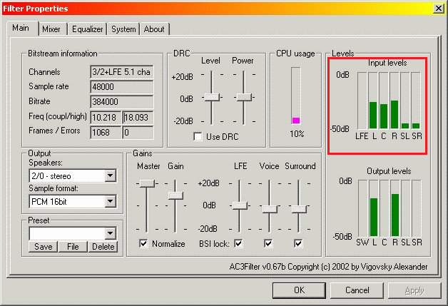

Install AC3Filter and use it to control visually what audio channels are worked.
Then change settings and see how it works.
http://www.svp-team.com/forum/misc.php?item=2709
AC3Filter_Input_levels.png, 214.77 kb, 628 x 429

You've helped me by making me realize my sound card driver had options for the Analog Output: Digital Audio.
It was set to 192KHz instead of 96 KHz.
This has fixed the problem.
Thank you so much for having cleared me from this tunnel vision.
