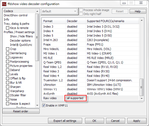

Try to use ffdShow video decoder as post filter.
You need to disable all formats and enable RAW
http://www.svp-team.com/forum/misc.php?item=2451
You will get LAV decoder + ffdShow decoder as post filter
RAW_in_ffdShowVideoDecoder.png, 20.12 kb, 568 x 479

Do i have to force ffdshow for h264 ? I did the trick but my soft launch LAV but SVP remains waiting for the ffdshow (logical to me)

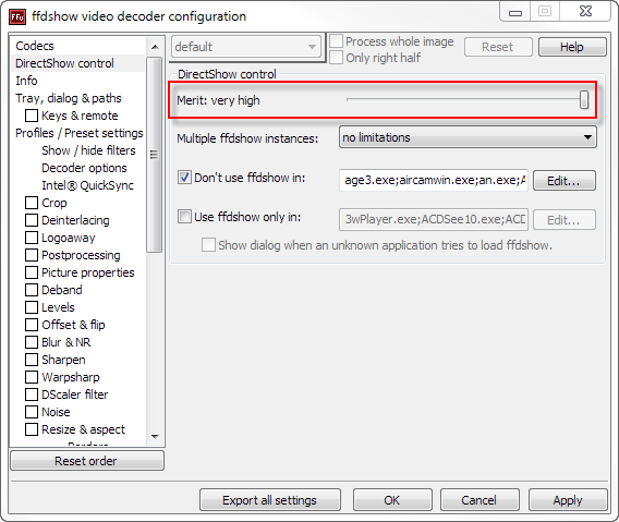

Try to boost ffdShow decoder merit.
http://www.svp-team.com/forum/misc.php?item=2452
ffdShow_Merit_VeryHigh.png, 17.13 kb, 568 x 479

Doesn't change anything. Still Lav launching at video playing and svp waiting for ffdshow

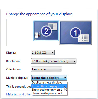

What the problem? You want to use Intel QuickSync? You not need in Lucid software. There is one trick: You need to enable HD Graphics output by driver. Just connect to HD Graphics output any monitor, reboot and extend desktop to that monitor.
* It can be the same monitor as connected to NVIDIA card but to another connector.
* You can move that monitor to diagonal position corner-to-corner to avoid mouse out from main monitor area and it is not necessary to use it in work.
http://www.svp-team.com/forum/misc.php?item=2463

"Just connect to HD Graphics output any monitor"
On my ASUS UX32VD R4002 i don't know which GPU is used when connecting to HDMI. I've also VGA port. But don't know as well which GPU is used when i plug to it. The SL and SV are forced to use Nvidia GPU even with the SV playing on the monitor connected to HDMI as the soft isn't compatible with intel GPU
Re: Lav Filters + FFDSHOW RAW
flashmp3
ASUS UX32VD R4002
Oh. It is laptop. Sorry. Then I think it have not direct output from integrated video to monitor. Only Virtu can help.
Trick works with Desktop PC.
