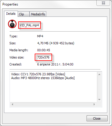

The video that you have shown me, it is 720X576 but its size is 704X392.
Is that okay or should be solely of size 720X576?
ORIGINAL MESSAGE
Il video che mi hai indicato, non è 720X576 ma la sua dimensione è di  704X392.
Va bene lo stesso o deve essere esclusivamente di dimensioni 720X576?
Re: Best configuration SVP for my system
Michael
You are right. I wonder. I missed it before.
Earler file was VID_PAL.avi and it was 720x576. Now I need time to think why our SVPmark test includes file with another resolution.
http://www.svp-team.com/forum/misc.php?item=2723
By the way, 720x576 it standard resolution of DVD. You can use any DVD for that purposes.
VID_PAL_properties.png, 9.81 kb, 387 x 435
