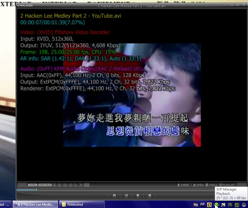

   I noticed that after upgrading to 3.1.3, kmplayer and ffdshow aren't reporting the correct framerate when svp is running, rather they report the framerate of the file. I know that 3.1.2 everything was fine. Is this a bug or normal for 3.1.3?

Here is one screenshot.
frame1.jpg, 283.69 kb, 863 x 724
Re: Is this normal or a bug-ffdshow and kmplayer don't report frames
I see 25 fps. Is it wrong frame rate?
Yes, before it would show the framerate that is actually playing because of svp, which is 60 fps + or minus.

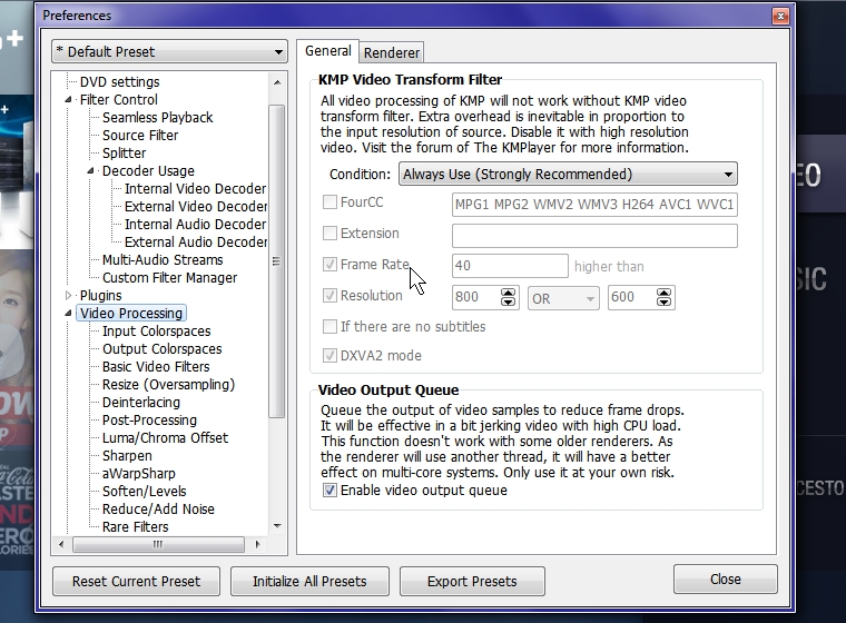

Solved, it was because i didn't have video transform enabled in kmplayer.

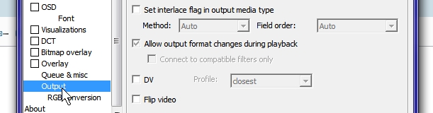

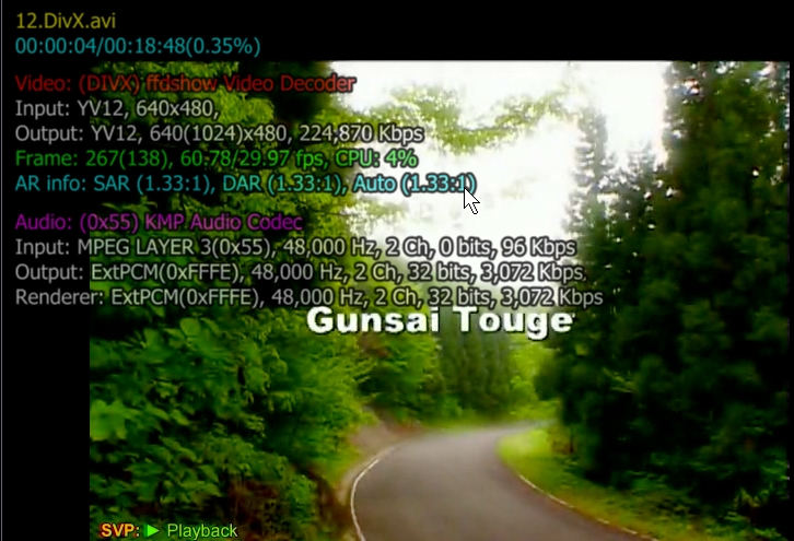

Screenshots here, in ffdshow have to make sure that "allow output format changes during playback" is like in screenshot so video transform filter in kmplayer works.
http://www.svp-team.com/forum/misc.php?item=2362
http://www.svp-team.com/forum/misc.php?item=2363
http://www.svp-team.com/forum/misc.php?item=2364
