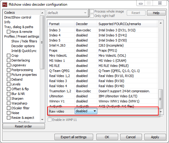

SVP uses first ffdShow filter in the chain. You can disable ffdShow decoder by turn off raw format at Codecs tab.
http://www.svp-team.com/forum/misc.php?item=2146
I think maybe SVP update will be needed soon. I missed this feature with two ffdShow. It is not critical but it raises questions.
ffdShow_decoder_raw_disable.png, 19.56 kb, 568 x 479

it works but FFdshow for some reason doesn't keep memory of the modification and next time you open MPCHC it gives two istances of FFdshow (Video decoder+raw) again sad

To leave ffdShow RAW only you just need apply some settings:
1. In SVP tray menu: Information - Hidden settings - change value of setting forceRAWinDecoder to 0 - close and save.
2. Exit SVP-Manager.
3. Windows Start button menu - Programs - ffdShow - ffdShow decoder - Codecs tab - change Raw video value to disabled as it shown at picture above - OK.
4. Launch SVP-Manager.
