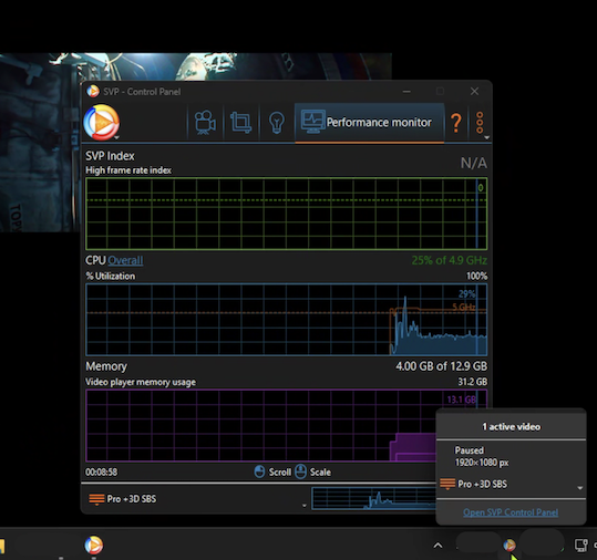

Well actually two things. First since I moved away from RIFE and started using SVP when I hover over the SVP icon in the system tray, it says "Paused" even while it's playing and clearly affecting the content. This probably ties into why the SVP Index graph shows N/A. If I reset everything the SVP Index graph starts working again for a few minutes then stops. So maybe it's the monitoring that is "paused"? The second issue might not be an issue in that SVP reports 1920x1080 for even though the file itself is actually 3840x2160. I've attached an image showing the two issues.
Screenshot 2026-04-10 at 20.22.58.png, 247.02 kb, 539 x 506
why it tells "+3D SBS"? is it really 3d sbs? then why 3840*2160? or the file name contains "sbs" tag? or you turned this manually, then why?
Yes. I meant 3840x1080 (not sure why I typed 2160). So SVP is only telling me about half of the frame?
