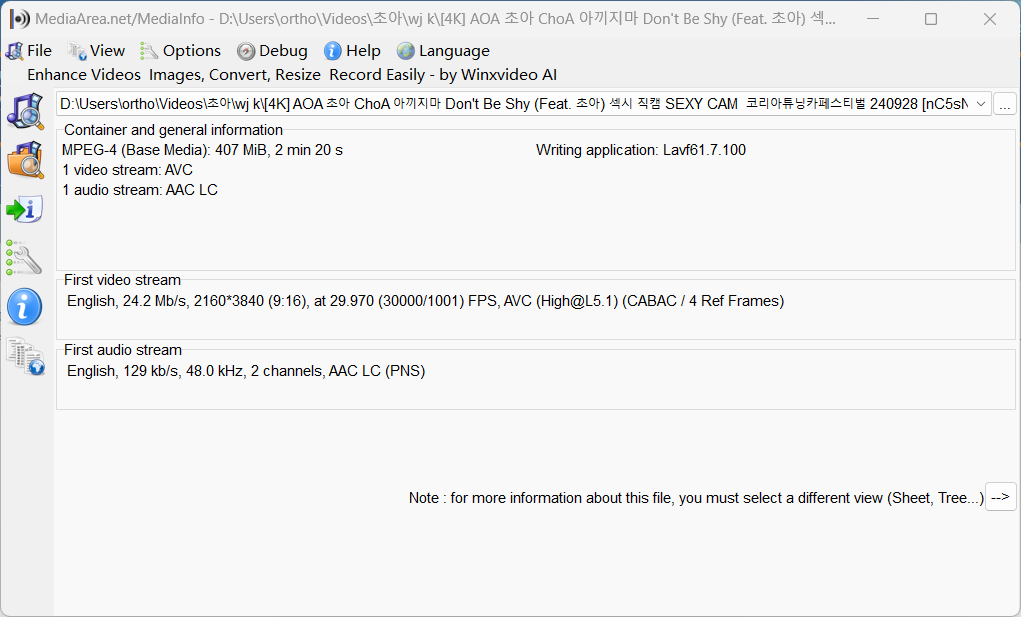

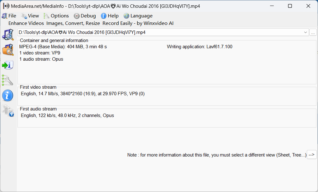

You can get mediainfo from your videofiles both horizontal and vertical one. And we will see the difference.

Please find attached

Different codec and bitrate, but both are within normal parameters. It might be the weird aspect ratio that SVP is struggling with?
Please find attached, also I used ffmpeg -i input.mp4 -vf "transpose=1" -c:a copy output.mp4 to make the horizontal video vertical and played it, there were also a lot of stutters and skipped frames.
