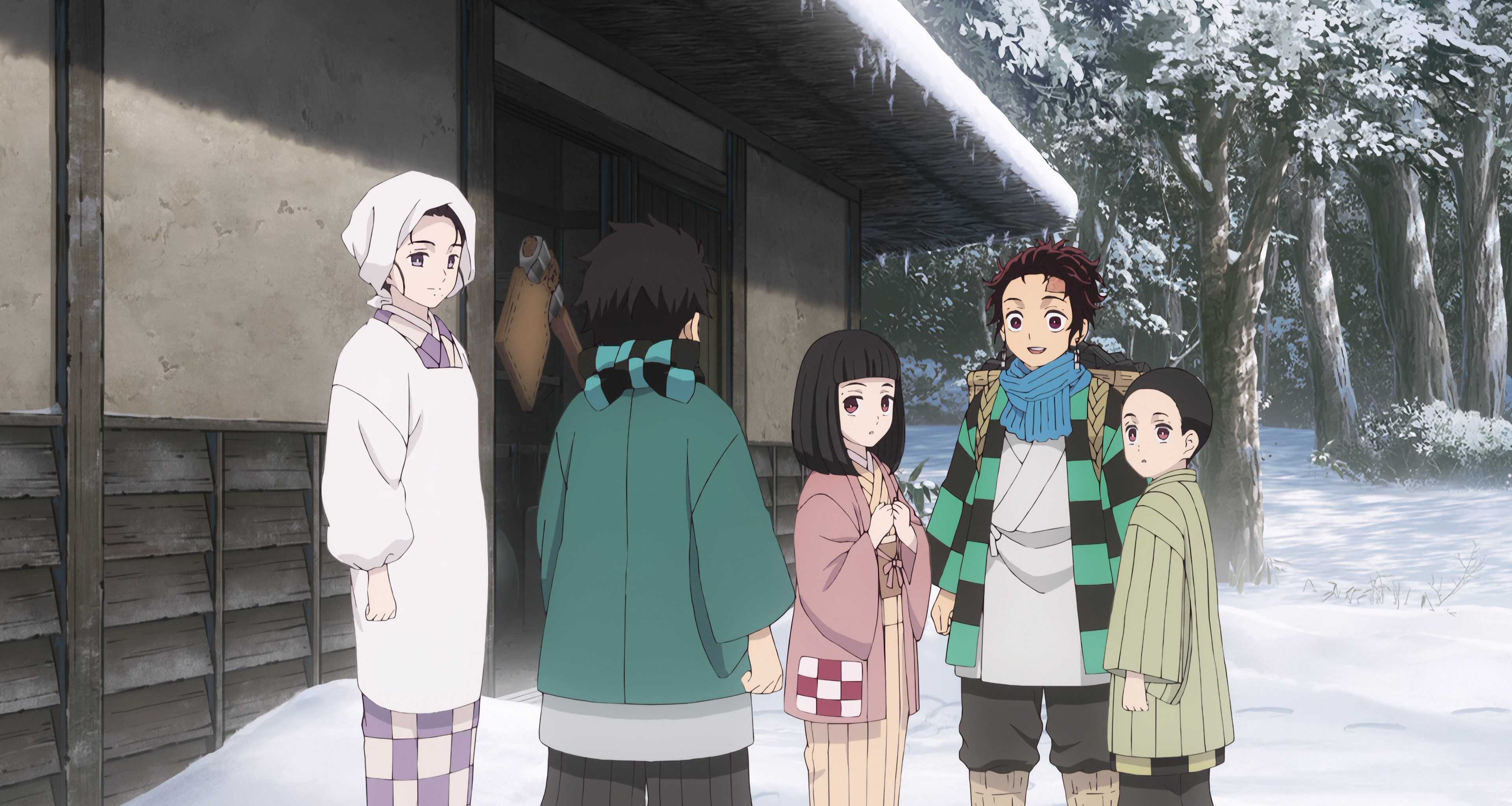

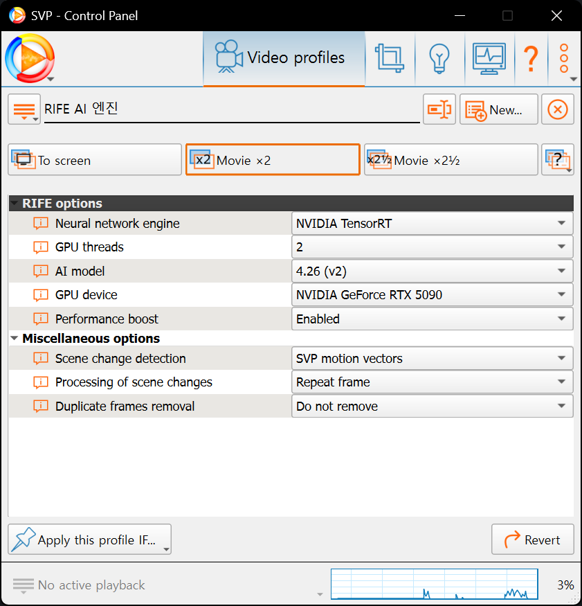

Topic: Bottom of 3840x2160 video is cut when using TensorRT RIFE
It's fine using SVP4 Automatic setting
It's fine using ncnn/Vulkan RIFE, but it takes too much resource and not really playable
It's fine with 1920x1080 or 1280x720 videos

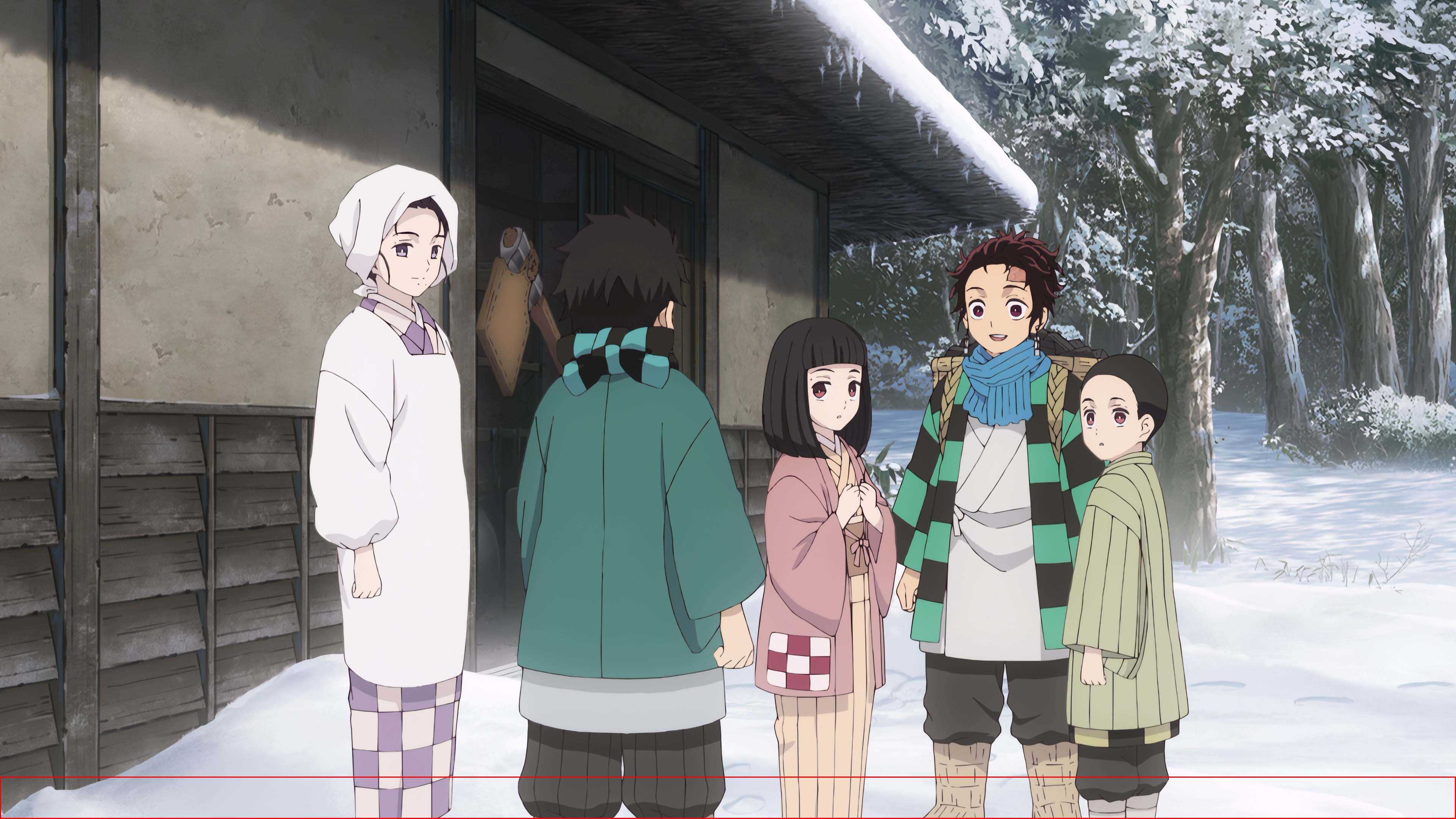

But 3840x2160 video is cut at bottom as shown attachments
Cut size differs from model to model, but every model I've tried of cuts bottom
Black bar detection, crop, lighting feature is turned off
If I turn on 'Decrease to FHD' or 'Decrease to QHD' it's fine
