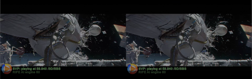

SVP has nothing to do with how your player presents a 3D image. That's purely down to your player and settings. However it sounds like what you are seeing is a 3840x1080 resolution image on the screen because that's exactly how it looks when presented properly. A thin strip going horizontally across the center of the screen with the top and bottom of the screen blank like the image below.
Screenshot 2025-06-22 at 00.13.38.png, 322.35 kb, 864 x 271

By "not working" I mean that the two full-SBS left/right videos are merging when I go into stereoscopic mode but they are not filling up the screen.  The top quarter of the screen is a big black bar and the bottom quarter of the screen is a big black bar.  Plus, the image is stretched horizontally by 2x.  It basically looks like the photo you posted above only the two images are merged and stretched horizontally.  This only happens with full-SBS videos like the one you posted above.  Half-SBS videos work just fine.  They fill the entire screen and don't stretch the image horizontally.

I've had problems with my self encoded FSBS files and separately with 3D glasses connected to a PC and the issue in both cases is that FSBS uses a 32:9 aspect ratio which is different to the standard 16:9 AR. The 3D glasses connected to the PC is similar to your situation and the solution was to use VLC with the correct AR. You may have to do something similar with your laptop.
