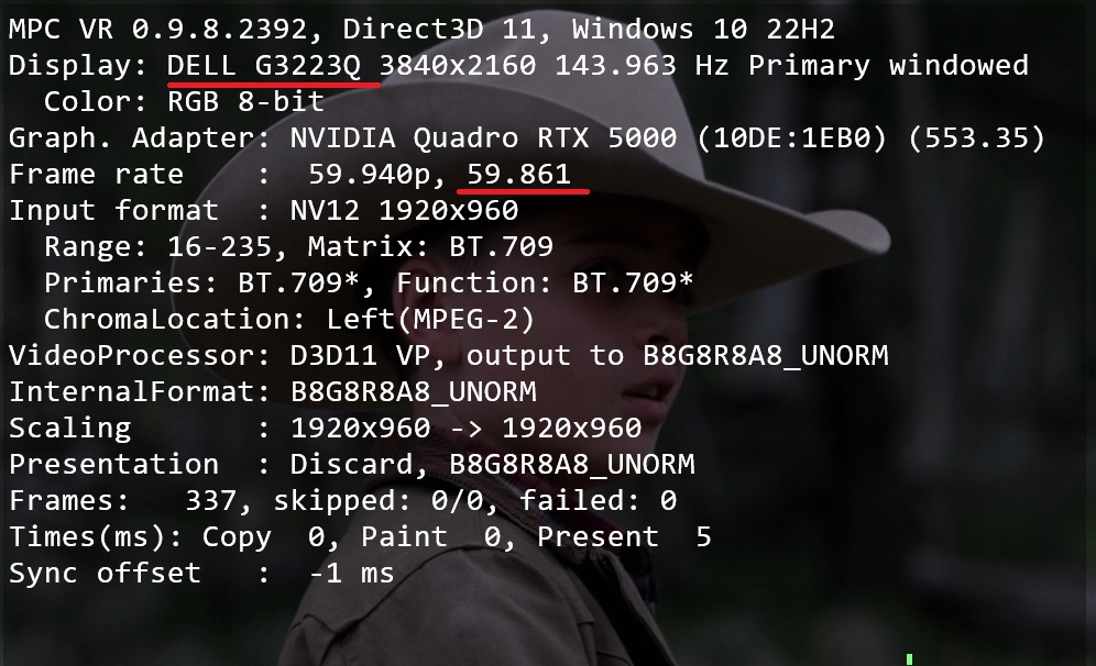

Intel i9-10850K + Nvidia Quadro RTX 5000 (roughly RTX2080 performance level) + Win10. I am using MPC-HC / MPV Video render output + SVP / fixed 60 fps. I can watch a whole movie without a single dropped frame and zero problem. This is my main PC.

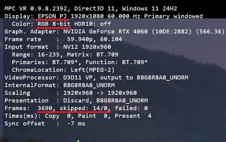

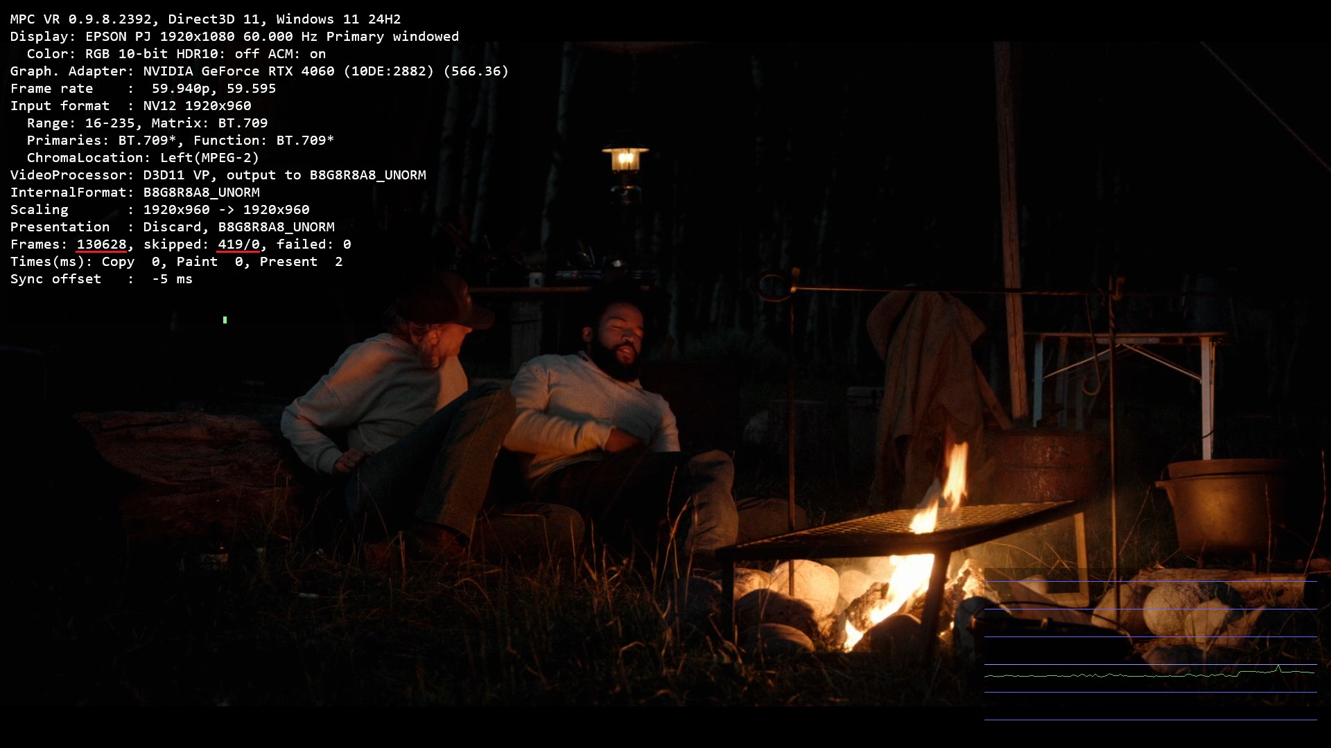

But now I have built a new PC in the living room just for watching movies (HTPC). Intel i5-12400 + Nvidia RTX 4060 8GB + Win11. I think both machine is more than enough for 1080p@60fps. But with this new PC i have a problem. There is a constant  stuttering and frame drops. It's realy annoying. I don't know what is the problem I tried many-many-many settings in SVP and MPC, i tried different VGA driver.... but nothing helps. SVP (and mpc-hc) is up-to-date.
I chose a random episode from yellowstone (1080p MKV). I can watch it on the main computer without a single frame drop, but on the HTPC there are more than 400 dropped frames.
Please help me guys. Any ideas are welcome.
I have attached 2 pictures showing the problem.
If you need any other info or details or settings or logs just let me know.
Re: stuttering and dropped frames
I wonder why the 2nd number on the "frame rate" line is 59.595 hmm
In SVP's log there's a measured screen refresh rate - what is it?
"I wonder why the 2nd number on the "frame rate" line is 59.595"
I don't know, but the 2nd number constantly and rapidly changing between ~59-60 during playback (on both machine), the 1st number does not change

"my idea is your Epson PJ for some reason has less-than 59.94 Hz refresh rate (59.59 ?), thus you have frame drops playing 59.94 content"

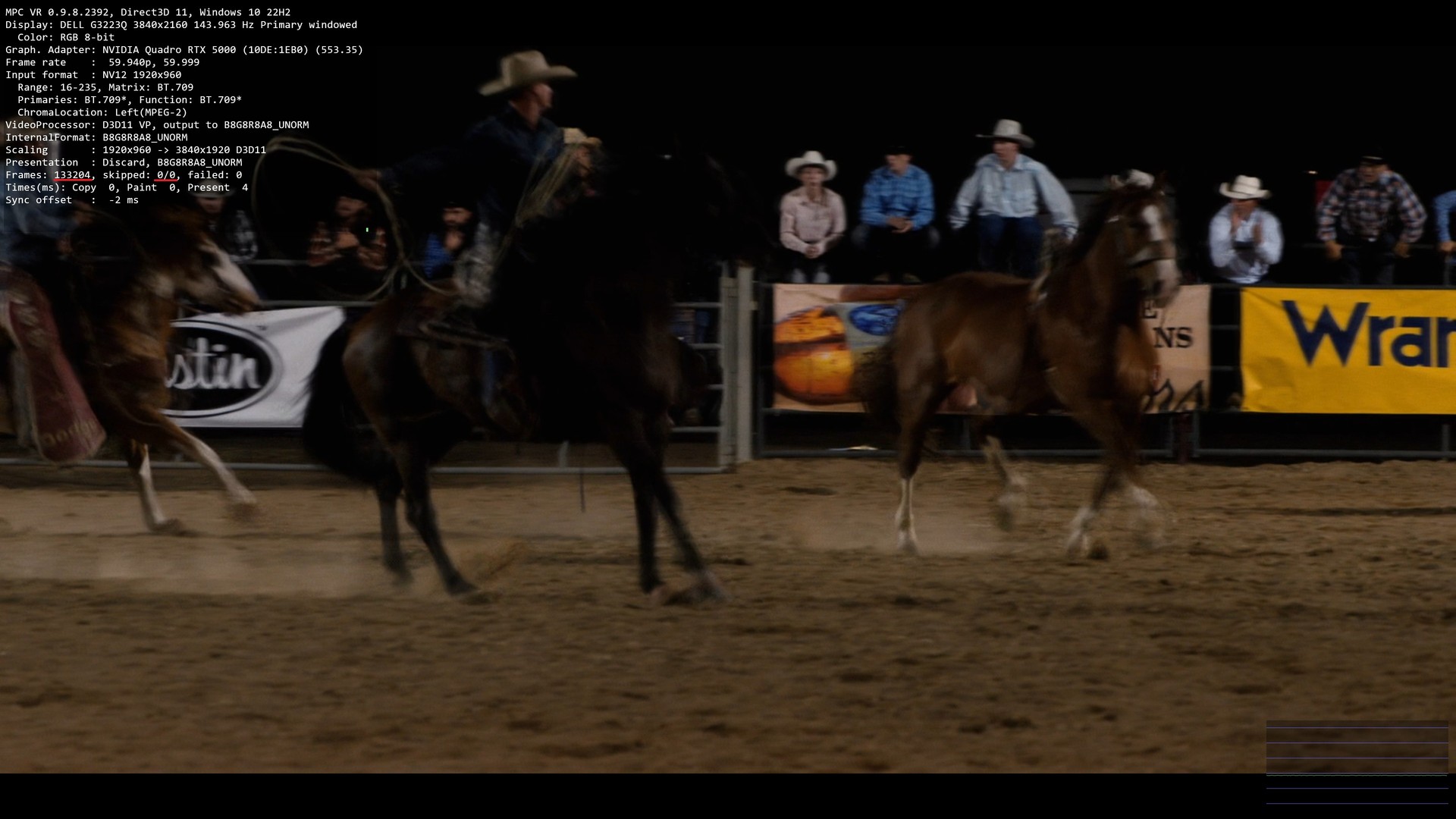

That would be pretty ugly... (but it is possible of course) and as I said before that number changing during playback. I attached two picture. HTPC above 60 and Mainpc below 60.

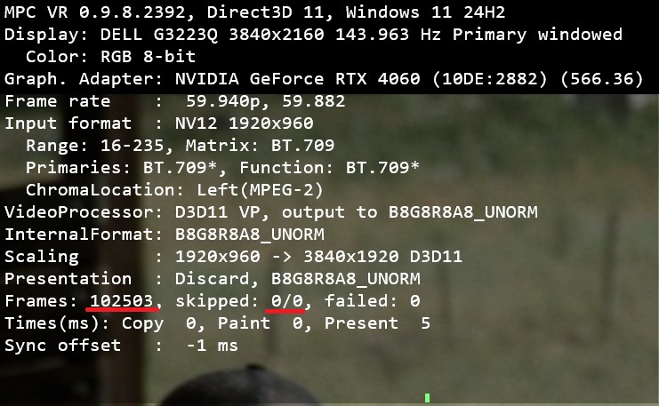

"what if connect new PC to the old DELL monitor?"
Some progress...
I connected the Dell monitor to the new PC and voila... ZERO frame drops (picture attached)
Okay, Okay... so... the new PC is good. This is good news. It seems the problem is the Epson Projector (or maybe the HDMI cable???) . This is is not good news for me because this projector is also new, I bought it few month ago and it wasn't cheap. Btw it is an Epson TW7100 if it helps...
So my question is how can i achieve fluid playback with this projector? Are there any SVP or MPC settings worth trying? Or what should I change? New projector is not an option smile
htpc_above_60frame.jpg, 130.15 kb, 738 x 456
htpc_dell_monitor.jpg, 98.77 kb, 741 x 457

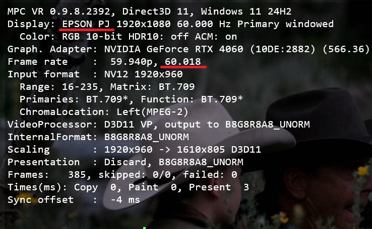

mainpc_below_60frame.jpg, 196.57 kb, 996 x 606

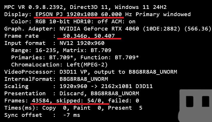

- I found the measured screen refresh rate in the log: 23:14:52.637: Screens: screen 1 - 1920x1080 @60.002 Hz [measured], x1.5 [95 DPI]
- I set the frame rate to 50 in SVP (this is lower than the projector frame rate), but it doesn't help. There are also dropped frames and it does not look fluid. So 50 frame is not good, not fluid enough and it doesn't resolve the dropped frame problem.
htpc_50fps.jpg, 114.1 kb, 736 x 424
dunno... turn off 10-bit mode?
8 (edited by dawkinscm 11-06-2025 12:36:12)
i did wonder about that when I saw the original post. But for mpv it doesn't make much of a difference and I would be surprised if it did for mpc. But I can't see anything else either so it's worth a try smile

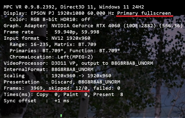

turn on "exclusive fullscreen"?
nope sad
htpc_fullscreen.jpg, 159.57 kb, 743 x 472

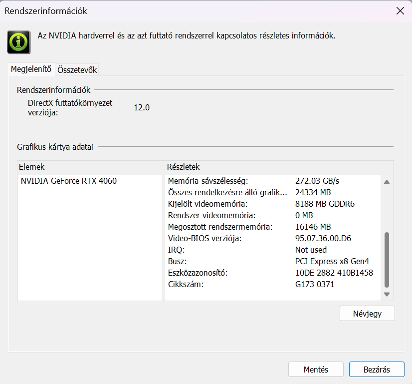

check PCI Express mode in NV control panel (system information)
there were several cases when PCi-E was at x1 mode for some reason
sorry for the language...
nvidia.png, 47.12 kb, 826 x 769
