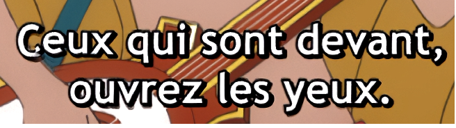

2,257 (edited by Sach 21-02-2025 16:32:50)
Hello,
I updated Vsmlrt with RIFE 4.26 v2 and akarin.dll.
I use MPC-HC with the Vapoursynth filter and TRT.
Now, I get some artifacts, and the subtitles wiggle with flickering.
If you look at the letter C, it's not entirely clear.
Do you have any solutions?
Also, when duplicate frame removal is activated, the video doesn't render.
Edit 1:
I uninstalled and reinstalled everything, but the same issue persists.
I used the files from the initial installation and the new ones from VSMLRT, akarin.dll, rife.dll, etc.
Edit 2:
I didn't find a solution for that, so I switched to RIFE v4.25, and it works perfectly.
