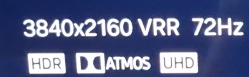

Adding to that , and don't even know if it has something to do but a weird thing happen. My display its a samsung tv that it has compatible Gsync and VRR that never engage on playback, odd as it sounds now on MPC Be for some reason sometimes engage VRR and you see a indiscutible improvement on playback.
Screenshot_20250105_222244_Gallery.jpg, 34.91 kb, 853 x 266
