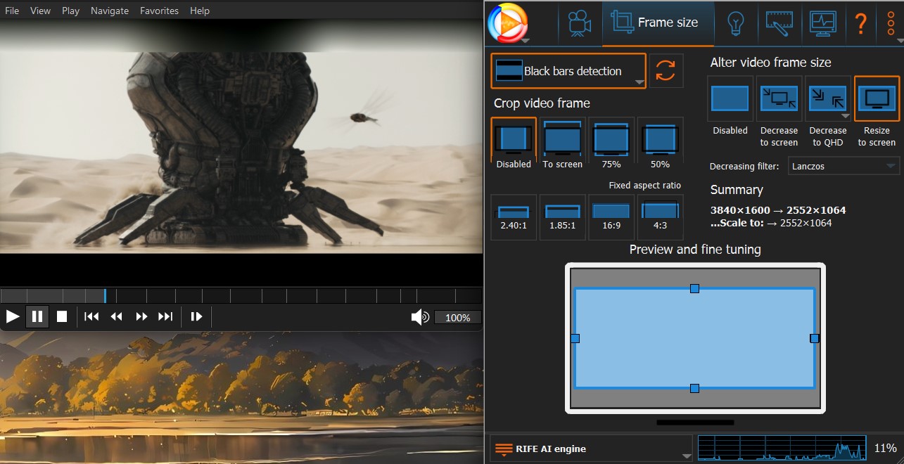

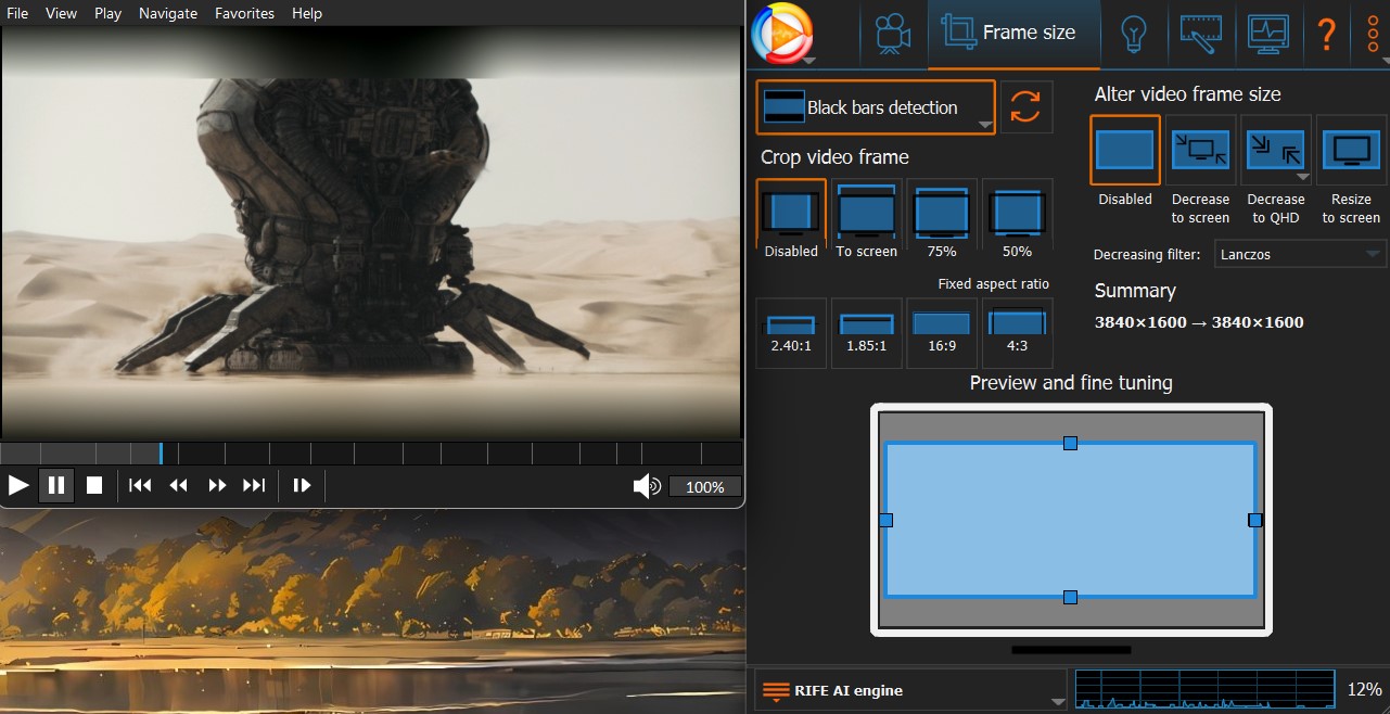

Hi, recently I ran into an issue when trying to use the "Fill black bars option".
I'm playing a 3840x1600 video on a 2560x1440 screen and for some reason when "Alter video frame size" setting is set to my screen ("decrease to screen", "resize to screen" or "decrease to QHD"), the lighting only appears on the upper border of the video.
When I set it to "disabled" or "decrease to FHD" it works fine.

Re: Black bars lighting only works on the upper border
replace SVP 4\script\base.py file
That did the trick, thanks!
