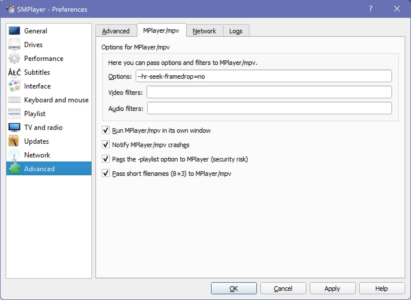

So I am unable to fix SVP working correctly with smplayer.
I have followed the instructions on getting smplayer to work with SVP.
https://i.imgur.com/rr6LQrn.jpeg
Now what is the current situation.
When I start the movie , smplayer is launched , it shows Dolby Vision and Dolby Atmos on my Tv when I maximise screen BUT SVP does not detect smplayer running.
I have checked running as seperate window but it does not make a difference in this case.
Now when I start a movie, and run it with mvp, it will get detected with SVP and run at 60fps but it gets detected as HDR10 when I maximise the screen!  so it shows HDR and Dolby Atmos on screen.
Does anyone know if this can be solved; being to able to run a movie in smplayer with Dolby Vision and Dolby Atmos on my Tv AND Svp detecting mvp running so it runs at 60FPS please ?

Also i see SMplayer overrides this setting general->video->Output driver which might cause issues related to color detection
https://gyazo.com/5b706354d3c45e0b2fac0ddc18aa8090
Try to set it on gpu-next?
Re: Problem with SVP and smplayer and Dolby Vision
Thanks for your suggestions @flowreen91!
Unfortunately this does not change much, gpu-next will only output HDR not Dolby vision for me.  So I will need to keep looking for a solution.
empty the cache and updating the apps also had no change.
