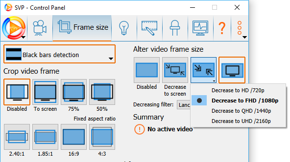

1,887
Hottea
Use frame downscale in SVP.
You need to press and hold mouse button to select resolution from the list.
SVP_downscale.png, 28.6 kb, 592 x 332

1,891 (edited by Hottea 03-09-2024 09:21:57)
Hottea
Thanks, it runs smoothly now. But i wonder does downscaling mean now i run 4k source at 1080p 60hz?
@Blackfyre: I tried to run 24hz source with rife 4.6 but it still stutter badly, gpu usage fluctuates between 100% and much lower. My 3090 is already undervolted and +1200mhz on memory clock stable. Normal svp runs 4k 60hz no problem but since experiencing rife's smoothness i cant come back to normal svp anymore. Maybe we need 4090 to experience 4k 60hz glory smile)
Thankss

1,893
Hottea
Downscale changes the frame size from 4K to a lower resolution. You can use 1080p, 1440p or any other value using SVP settings in additional options.
Downscaling results in a loss of quality, but may not be very noticeable.
It is all depends on the quality of the source.
You can set up your profiles as Blackfyre said.
He is 3090 owner here.
Custom refresh rate 48 Hz is good solution.
